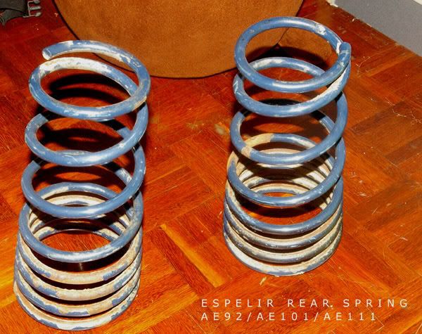

i have an ae101 espelir rear springs from japan for sale...
if you want i can let go RM150 only....
