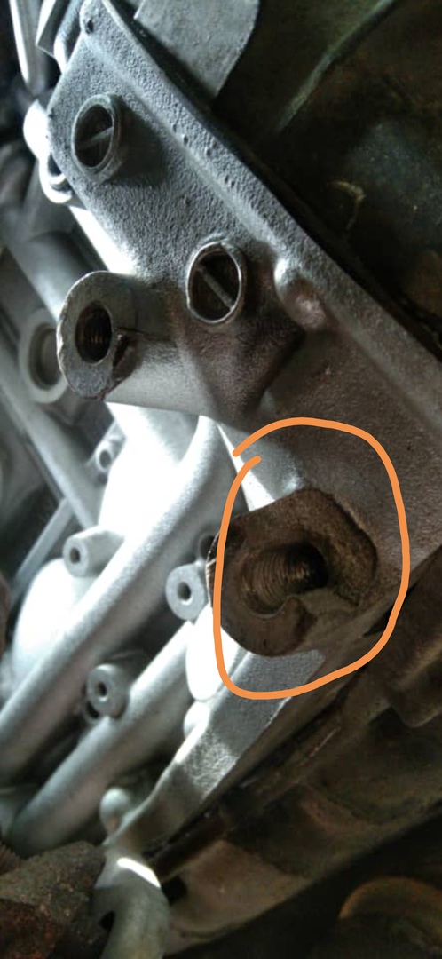

engine mount block? What does this lock down to? I mean what is connected to this part of the engine? And more importantly - how did it break?
Need to change name from BrokenJars to BrokenSomethingElseThe holes are for my car front engine mount. I do not know how it happened. My mech told me about it when he was changing my clutch. He said it was already broken when he saw it, and my mounting still can tighten to the holes. However I want it repaired. I know it can be done, but where is the place and estimated price?
Also, no point of me arguing with him as I do not know when it really breaks.
look like you get ur car run back.Hi guys, my engine block mount bolt hole broke off. Engine is made of cast aluminium. Can this be welded back? Also which shop do i go to? Penang got recommendation?
Thanks
TIG weld oso gol aluminium rod right?
Just need to add more metal, drill hole, then tap the thread?
Sounds simple when i put it in words...hihihi.
I am not worried abt engine internals, only the seals. Thats a thick piece of aluminium thus takes longer for the surrounding to heats up.Apparently need remove whole engine block, remove the insides and bring only the shell to the workshop only they can do. Cannot direct do while on the car apparently, due to they are afraid the heat generated might damage the engine internals like seals etc.
Get a new blockI am not worried abt engine internals, only the seals. Thats a thick piece of aluminium thus takes longer for the surrounding to heats up.
If the area is spacious to weld and drill then i do believe it can be welded while the engine is in the car. Weld a bit then stop, weld then stop, let the metal cool down in between weld.....Unless there is a seal very2 near to the weld area. Then again, if only one or a few seals and its easy to replace i will sacrifice the seals.

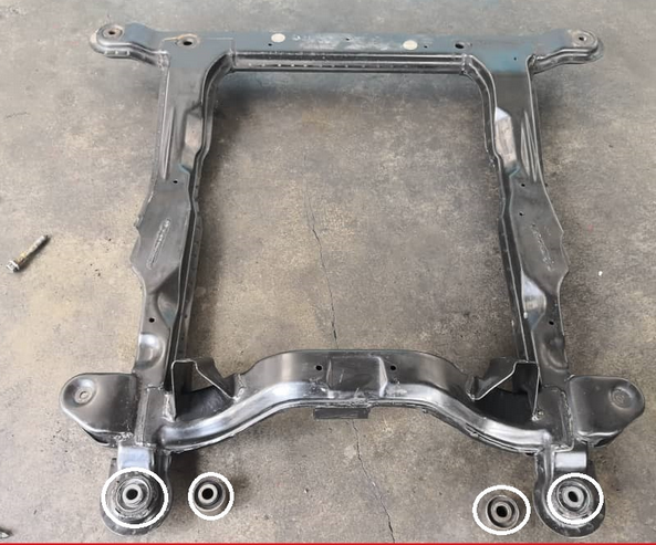

Your dilemma is just like what i am experiencing with my BLM which got a worn out sub frame bush. To replace, workshop will remove the whole subframe so they can press the bush out. Labour is quoted between 300-500....for replacement of parts which cost only RM40.
Isnt there a bush extraction tool they can use without removing the entire subframe?with my BLM which got a worn out sub frame bush. To replace, workshop will remove the whole subframe so they can press the bush out. Labour is quoted between 300-500....for replacement of parts which cost only RM40.
Got....BLM got subframe bush?
Yes...but they are sold as set and will cost frm RM300-450.Isnt there a bush extraction tool they can use without removing the entire subframe?
My engine very rare wor.. sr20ve 20v. Also just done full overhaul 1 year ago, very waste if change the block now. Current countermeausure is just custom add 1 more anchor to the engine mounting. So far so good la. My from engineering sense, it looks like it can last. :PGet a new block
