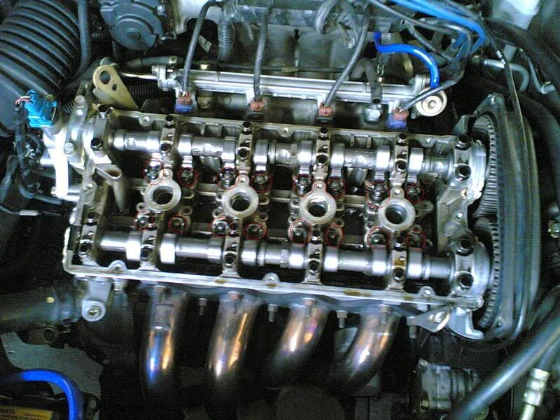

this is how your tepet will look like:
http://i23.photobucket.com/albums/b371/potssum/auto lash/auto_latch.jpg
and this is the location of your tepet :
http://i23.photobucket.com/albums/b371/potssum/auto lash/autolatchlocation.jpg
few months ago i fitted my car with a pair of R3 stage2 cam... in order to compensate the gap(regrind cam ).. they will insert a metal shim under your tepet... but with single shim inserted the tepet sound still arise(for my car) finally last weekend i decided to insert another shim on each tepet and walla... no more tepet sound for me... :)
