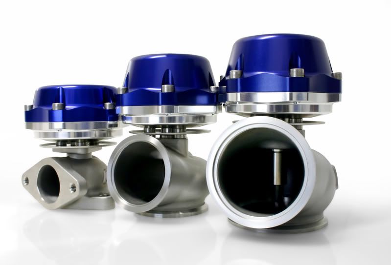

Turbosmart wategates..2008 models..solid CNC machined valve stems and strong nomex silicone diaphragms.
All in stock now..
Call 03-6187 8833 (master distributor)
if im not mistaken the turbosmart's good stuff cost slightly above 2k onwards... am i right..? correct me if im wrong...
to correct misperception of Turbosmart.. behold retails prices..
38mm - RM 1,005
50mm - RM 2,000
60mm - RM 2,500
Brand new.
For more info...ring our Authorised Dealers for better prices
