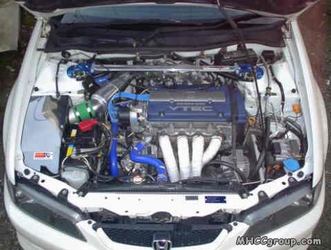

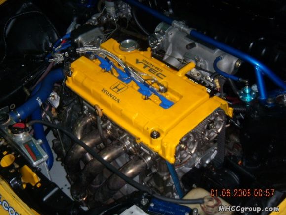

engine head cover colour like this

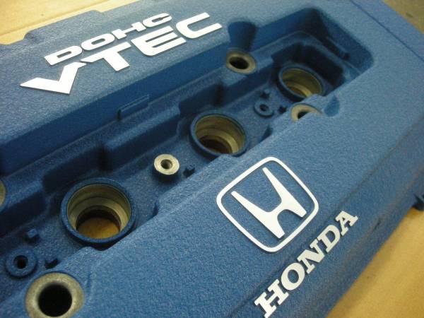

Anyway, here are couple good pictures of an example on b16 head cover. ichiban.
