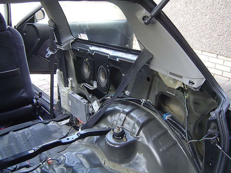

bro hattech... the ECU like thing in this pic is the ECU for tcs and abs ah?
