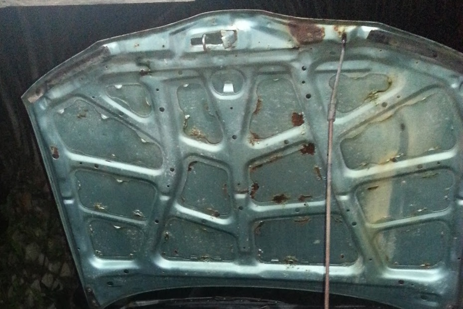

Can only see the front. But it looks almost identical with mine. Same grill and bumper also just that I don't have the foglight. :biggrin:
This is so random. I heard that the reason is that the glue traps moisture which later on causes the bubbles to appear. I wonder does this happen to Satria and Putra?
I searched around at google and found out that in overseas, many Lancer CB/CC owners suffered this same problem like Wira. Even real Lancer Evolution doesn't escape this disease. Mitsubishi made an engineering mistake, Proton went and follow up...
correct, it traps glue + its acidic..... those 2 together = rust...
according to what i understand, you have to get rid of all the glue if you want to solve the underlaying issue... when i repaint my car, i wana keluarkan all the glue also, just not sure how...
some mitsu's during that era also suffered the same fate, lancers and my car all the same....
How to remove all the glue?
Now that I replaced my hood with a new one, I wonder is the new hood made using the same glue method?
I'm not sure what other cars have roof rust bubble issue but I've seen a few N16 Sentra suffering the same roof rust issue. Maybe glue method again?
But I thought for body work mostly local dy, engine is Mitsu only.....:smokin:
You know those globs of plasticine like substance that holds the subframe to the hood's skin? That's the glue you have to remove. You have to forcibly scrape them off. After which, you may see traces of rust on the exposed surfaces. Best to first treat with rust converter, followed by anti-rust. Do bear in mind once they are removed, the think sheet metals that forms the subframe may vibrate
you removed yours?? mines like solid cement.... cant even scrape it off!! was thinking they use an angle grinder to do it or something...
Nope. I dont think I can tolerate the sound if the hood reverberates. I bought the mivec hood in hope that corroding hood wont happen again. At least not so soon, anyway
My new hood also got that kind of thing there.
Same goes for my rear bonnet but that is worse. Is in yellow colour. Like glue colour while those in my hood are sprayed in same paint as the hood.
If remove the old glue, need to paste something back on

Same family of cars, maybe Putra will suffer from it also. Don't forget Arena.
from what im told, later batches dont seem to have the issue (agak agak post 2000).... it seems to be true, those of my kawan who owns the last batches of these cars, no rust issues (aside from those due to collisions)
