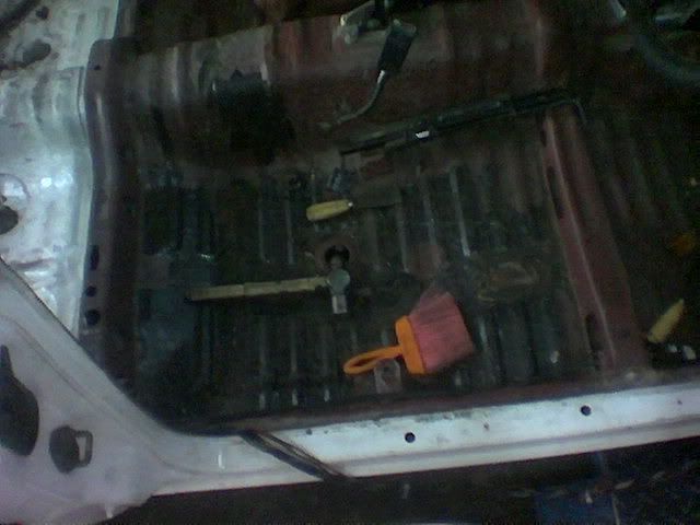

Scraping the thick bitumen off the floor pan for spot welding.
Laboured almost half a day and barely finish driver side oni :frown:.
But the result was worth it. :smile:

A fren of mine who scrapped ALL the bitumen coating off his car (he practically stripped his car down to the bare shell and put on a "BBQ" like roller) told me the total weight loss from the bitumen is about 15kgs.
Well by the time, I get to 15kgs of bitumen loss, I'd be totally spent.
Oni half a day of scrapping the bitumen on the driver side floor pan is gving me a back and neck pain :bawling:
joeker,
don't mind me asking, what's the purpose of the bitumen anyway? was thinking of removing it from my car as well, but gonna take ages like you said.
its a sound deadening material.
All cars are coated with this bitumen to reduce the road-vehicle-harness (NVH) into the passenger compartment.
Yes, its very tedious work removing the bitumen.
Do it in stages.
As you go along, spot weld the seams for chasis reinforcement.
actually its the other way around.
Before spot welding, you MUST get rid of the bitumen or else the welds won't hold.
