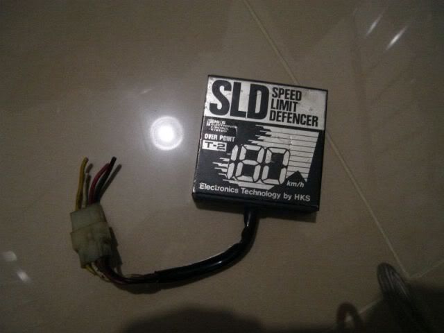

haha..ok2..fyi..my kancil already using 240 injector, adj fuel regulator, walbro and also have fcd..and the last thing 1 wanna do..i want to upgrade the turbine..hehe do u know any gud workshop..? by the way..do u join kcarlife convoy and gath to melaka on this 25/12..?

gud thing about management is i have safc 1..but the sad thing is my safc is lost at sum1 hand..so rite now i waiting for the replacement..is almost 4 months already..mine fr set 3 bar if not mistake..where is vacum attach..?
