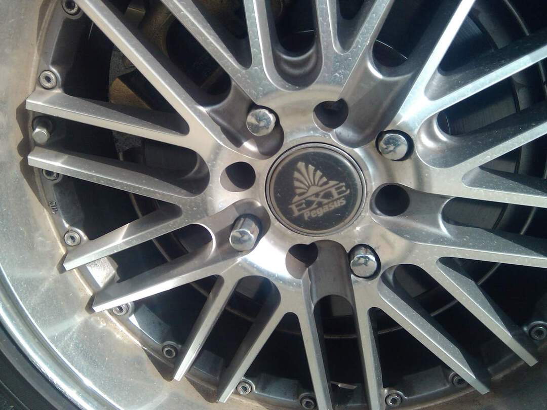

Try to check the tyre code on the wall of tyre.
I believe it should be either 205/40/R17 or 205/45/R17 + spacer.
Tyres are 205/45ZR17 ?? rims not sure exe pegasus?

its much bigger then the original size imo, so u need to add sum percentage on the tripmeter reading

With this tyre and rim size, you can add around 2.5% for your actual mileage.
But i have no idea your rims are made in which country.
