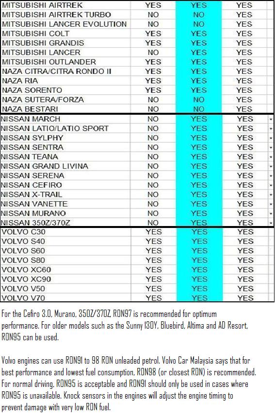

U still need to buy octane booster right.
I can summarize from your comment is ron 95 cannot use unless you are truly desperate.
If you say ron 95 is ok, so you must try to test pure ron95 for a month.
I have attached list of car can use RON95.Is it true I also dunno.
Maybe the older model 4g63 cannot take RON95 than your new brand 4g63
