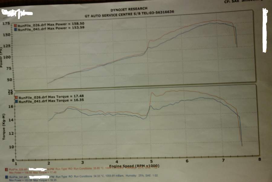

This must be one of the longest MIVEC threads around. I believe lots of sharing of experience and expertise esp. on gen 1 1.8 hybrid. Many modders here have matured to realize the results via butt feel to dyno runs. And I believe, it is this that would brings the modds to next level. I've seen quite a number of dyno figures quoted which can be encouraging. It would be great if the dyno charts could be furnish as well. More information can be gain and modd comparison purposes to learn something from it.
Attached is my recent dyno run.
1st run = 153 hp. (mixed pipping size , s-flow muffler and center box = 2.1 , pipping size 2.5 - non mandrel bent)
2nd run = 158 hp. (Changed made , ran full 2.5 pipping with 2.5 center bullet and 2.5 straight flow muffler , full mandrel bent)
Hp gain was minimal 5 hp, however torque increased by 1 kg, noticed minimal lost running full 2.5 pipping.
My setup:
1.8 mivec hybrid = 4g93p lower block + mivec head. Only mivec component is the mivec head. Wiring and ecu = 4g93p. Running the so called cusco replica 4-2-1. Still using the stock box intake with k&n dropin. Lastly running the gsr intake manifold however not port match to the head. Mivec trigger via RSM, engagement point at 4800 rpm. static ignition =5.
?? from 2 Dyno run:
1. downwards torque curve afer apox 5200 rpm; is that normal, thought the curve should be progressive on an upwards and tapper down at higher rpm perhaps 6500 rpm .. any idea ...
2. torque and hp pretty low before the mivec engagement ; i would at least expect it to be better than the 4g93p as that is the adv of the mivec however seems not the case , any idea ..
3. would you think a open pod with CAI , help with the torque as whole ....
what you reckon ....
Cheers
