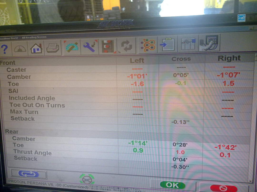

The allightment and camber done was bad.. The shop charged rm60 just to add washers. I came back to the shop after a while because my allighment was out
Just feel ive been conned on the camber pushing. They charged rm240 and stil my allighment is not good.
Just go to another shop for alignment, if they cannot do it right the 2nd time means they are crappy.
This was my original before they touched,
rear camber was out, so they put washers to make it back to 1.14, so took a car for a ride and came back after a while cause my car was going towards the left when let go of steering.. this time he recommended to do the camber pushing.. after doing that also still alignment lari.. got charged RM300 for all this and still not perfect. Was rushing today so had no time to go back again.

Since you need the reading, can go back to them first and see what they say. If you can take pic of the current reading and post back here will be good.

Your front toe is wrong -1.6 left +1.5 right means tire like this( // // ). Camber of 1 is ok toe will eat your tire fast. The more camber the more cornering grip. Hydraulic press will damage your suspension, camber nut is design for a reason :banghead: use it.

I know how a alignment machine work (i do my own) As u can c the pic posted, TS say that is the 1st reading B4 alignment meaning left is -1.6 toe out, right 1.5 toe in, ignore the centre value cos it only let u know the diff, n the machine is not properly maintain as u can c the reading is wrong, the diff is -3.1 not -0.1, that y his car going left side. The machine need its own alignment too just like a printer.

Brother, don't get you. One side toe out and one side toe in, means facing same side, so you cannot add the total. When steering is straighten it will be -0.1. Yes, I agree that the alignment machine need calibration at least once a month.

He was saying perdana v6 original rear camber reading is 1.0, rear toe is 0.5
the front toe he was saying if + both it will become 0, not sure about that, also i forgot what he mention about the original camber for the front.
Car was still going slightly left sideways until i fixed the air pressure myself at a petrol station today, front tyres 33, rear 30(all tyres different pressure lol).. I'm not sure about the correct pressure to put for my car..
but im still blur why the rear is both is 0.4.. front one is -0.1, 0.1

If his alignment machine is with car data and set to your car make and model then those with green reading should be correct and within the tolerance. How did they do your front camber adjustment, as now the reading is near zero, but I would have left it slightly more negative.

The reading look okay now, and the rear toe look too small to affect front steering to go left.
Too bad got no caster reading, as this can also cause the steering to go left if one side more then the other.
