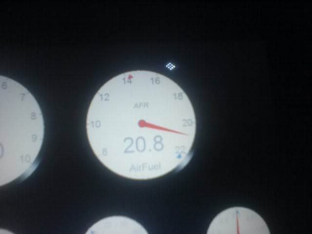

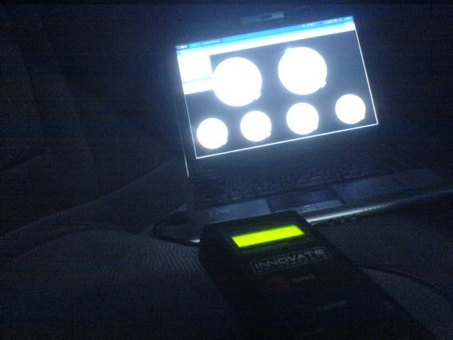

my idle AFR is impossibly lean, as you can see.. leaky valves gives bad AFR readings, which is why never tune unless you know the car can give proper AFR. I mentioned this in my previous posts, but today was the day I remembered to use the handphone camera, and I just happen to connect the wideband and set it up for another laptop.
Well, just a little longer for those wee LMAs to arrive, then I can look forward to smooth running engine with a slightly higher compression.
Idle at 20.8, crazy!

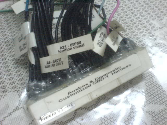

Innovate's MTS is designed so you can install it in any kind of car though, because it's generic, but that's where the problem lies. There's no PNP harness, so I had to fabricate my own, and so should you, because if you butcher the original harness, it'd be a headache to track down wiring issues when it happens.
Trust me, I dug through enough wire harnesses to know. it's not easy probing them either, had to make some custom probes to fit.

lol.. that one is a sign that the engine not giving proper reading lah..
putting it in another car in good condition gets 15 at idle.
