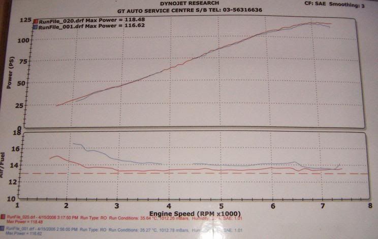

Joeker said:HKS,
Just Dynoed today.
The rear wheels of my Corrolla stomp out 118 on-wheel horsies!!! I'm really ECSTATIC!!! :_:
Here is wat went into the engine.
1. 4AGE 16 Valve (Big Port)
2. Port and Polished head.
3. TRD 0.5mm metal gasket.
4. Lightened flywheel
5. Exedy Semi Racing 3 puck clutch and Diaphram
6. TRD plug wires.
7. Silvertop ITBs adn custom intakes.
8. Adjustable cam pulleys.
9. Aluminium pulleys (crank, Water, alternator).
10. CUSCO 4-1 Extractor.
11. 2" piping.
12. 2" staight flow Muffler.
13 Apex-I SAFC2.
Hope I did'nt leave anything out. Will upload the dyno chart soon.

Joeker said:DYno chart.
