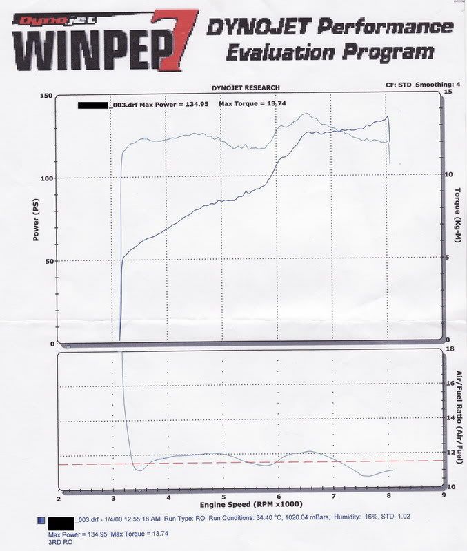

dyno my b16a the other day,only 134whp
afr 12 from 3krpm to 6.5krpm
afr 11 from 6.5krpm
as long it doesnt knock at this scorching heat malaysia weather its ok.

heres the chart
b16a
stock airbox with arc intake chamber
spoon plug cable
itr intake manifold
itr cam
stock extactor
ported n polish and skim head
chipped ecu with cheap chip:rofl:
only134whp:mad:
