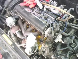

Does it look like this.........................i mean the blitz turbo kit? Got the pic from a friend....owner unknown......
Fuiyohhhhhhh..........how much Hp at the wheel can actually this turbo kit produce?
It will produce 250HP, dont know is wheel or on engine. Trial tuning got experience with this kit because they used to have quite a few of it. Comes with Blitz ECU also
walau...whole kit is 798000yen=30K plus in ringgit.
as much as transplanting a JZ into the tezza(with intercooler and change to spare)
