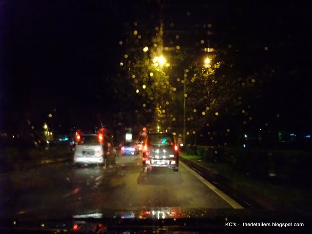

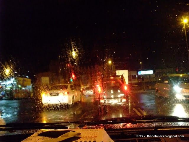

wow - you guys really play with FIRE
careful pls - with yr body (Fish- eg is great) and wear protective eye gear & acid repellent gloves
this I opt out - cos i have 2 young children at home -
some pic to share
What i did was this
a simple coating
on my 22 yrs old @face
the non coated side (water marks cos blur/poor vision)
Optimum coated side (after 15 months)
the 50/50% view
until today - i have not change the wiper (at least 3-4 yrs old blade) cos i dont need one in rain
will post u the video in my blog soon
JUST have fun & not fire ya
