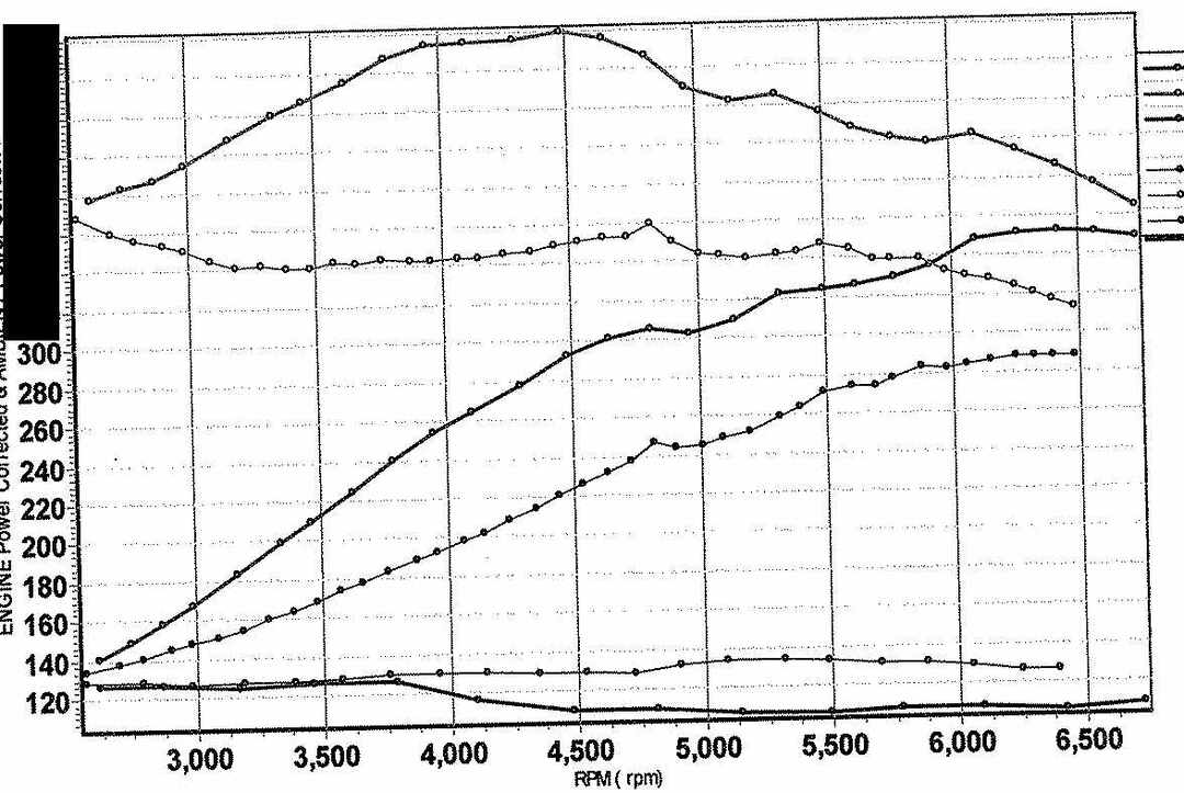

SC kit comes with preprogrammed FConSZ, i suppose Fcon control the AFR with engine "safety" in mind, at lower RPM it is safe to keep the mixture at stoichiometry. I suppose you know lower AFR is safer to modified engine, but least economy. Tuner normally dare not take risk therefore they adjust your APR lower, but this japanese product have promise the fuel economy in its product intro. Like you, I was wonder how the fuel economy can happen after supercharged until i observe this issue.
You can get real time AF reading from ECU and there are many tools in market able to read ECU. I use DashDyno scan tool and BTOBDkey. Dynorun result at any shop can produce the same results.
If you want to know deeper about it, you have to contact my tuner, Kenny Lee (Kegani Autotech) 012-6646177.
I attached 1 of my dyno result for your perusal. Bold line is after HKS SC.

great improvement btw....
