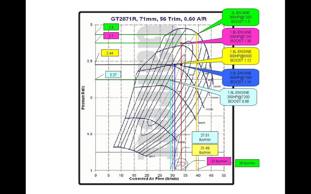

Compressor Map GT2871R
cONStant Parameter in Calculation
BSFC = 0.55
Manifold Temp , Tm= 130 F
Gas Constant ,R = 639.6
A/F ratio = 12
Volumetric Efficiency = 90% (DOCH Engine)
Engine = stock
Need UR cOMMENT :listen: *the graph plot not to accurate, pls refer to value
Enjoy...:marchmellow:

haha come on la bro..im just sharing..no rite or wrong :proud: let discus together-gether..:listen:
after gt2871 i will come out with other model..we start from medium size first :)

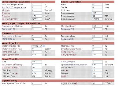

aiyo lazy la bro to calculate calculate
i show u wht i have already calculated for my car hehehe
1.7bar Boost
VE set to 90%
AEM Methanol Injection with 315CC nozzle
50trim T04E turbo (small turbo only mar)
output will be around ~400hp
but of cos , many more variables which I dont have knowledge of on the calculator

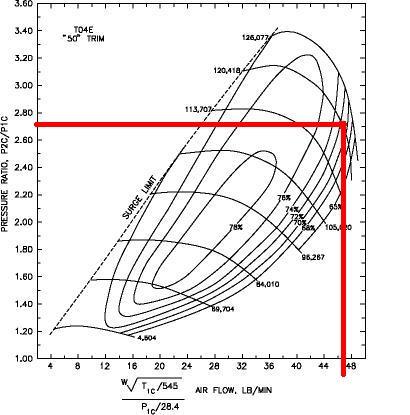

1.7bar Boost
VE set to 90%
halawee bro..too small..cannot read la bro:captain:
besar la sket...bro ala u dont worry la using 50 trim TO4E u will get very nice range of power (power band) ON 2L engine...Responsive turbo..the prob is too hard to get 50 trim:)..i will show u my calculation later..ok

http://img169.imageshack.us/img169/5042/calculatecx6.jpg

i ordered the fin from US , fin n shipment USD100 :banghead:
I heard , if u have ported the head and also included higher degree cams in the engine, u should put a higher VE figure
yes bro VE chANGE IF u modified stock engine..for stock engine DOCH can use 90~95 sOCH USE 80~85 (estimated-its depend)

bro inlet temp u put in too cold la.. better put 30 above..Malaysia ma..hehe..
then about pressure drop in piping can used 2 psi (suggested by Garrett)
