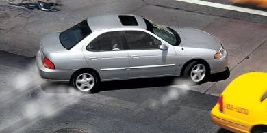

One way to induce oversteer in your front-driver is to plow hard into a corner and then lift off the throttle in the middle of the corner. Lifting off the throttle will cause the weight of the car to "shift" to the front, thereby putting more weight over the front wheels and, ultimately, adding more grip to the front tires. However, if you are lucky, the rear tires will lose traction and start to slide outwards while you're turning. You are now oversteering. Some countersteer now has to be applied to keep control of the slide, that is, steer in the direction of the slide. Learning to precisely "catch" a slide will take a lot of practice, so it is better to play around in an empty gravel lot or a slippery track with large run-off areas. Start off at moderate corner entry speeds and then increase this speed as you become more confident. This technique is only possible with well-balanced front-drivers such as an Integra or an old Sentra SE-R. If your car can achieve oversteer in this way, you will generally be cornering faster. Practice with lower entry speeds, and gradually increase it as you get confident.

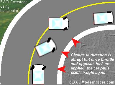

A brute-force way to induce a slide is to pull the handbrake (or press the e-brake) momentarily and yank the steering wheel in the direction of the corner, then countersteer. For example, to take a right-curving corner, you could plow into the corner in second gear and as soon as the corner starts, yank the steering wheel to the right and a split second later, pull the handbrake. The rear wheels will lock and suddenly lose traction. The car will quickly go it a sideways skid, at which point you quickly start countersteering. Now, before exiting the corner, release the handbrake. The front wheels of the car will just try to pull the car straight again and you'll have to steer exactly where you want to go. If you don't release the handbrake in time, you will spin. If done right, eventually you will center the wheel and straighten the car. Throughout the turn, keep the accelerator at a constant position, but you can apply a litle more throttle on the exit if you think you are spinning out. One hand should always be on the handbrake, with the button depressed, so you will have to turn with one hand. The sudden slide is a little hard to control on the first few tries and requires quick reflexes. And, as stated earlier, a continuous slide around the whole corner, like those done with rear-wheel-drive cars, is not possible with a front-driver. Pulling the handbrake to turn around a long radius corner will actually worsen your cornering time in most cases, so it is not a technique for road racing. But it can save you if speeding and understeering off a cliff is eminent.
