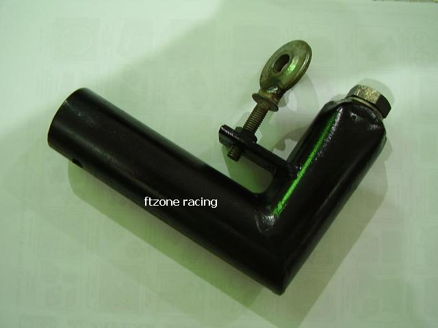

yeehar... my own fabricated o2 sensor exhaust clamp. =) It's fugly... haven't sorted out the internal venturi effect yet though...

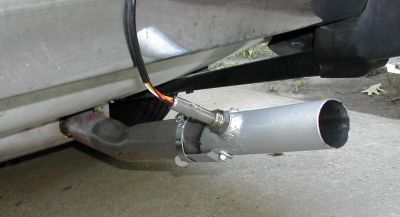

another straight forward design... it's ugly.. but it should work...
found somewhere in the internet.
