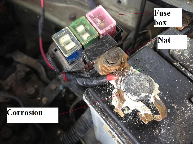

Sorry for the delay guys.Not online for few days.Here is the picture:

I see a nut there. When unscrew can the fuse terminal be detached? If can, then attached the new terminal to this....

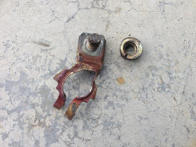

Finally its been solved.I bought a new MF batt and terminal.
Ended up some slight cut on my finger after battling to open the corroded screw :(
But im not satisfied with the battery terminal which looks like a normal terminal.Need to buy a good terminal later.
