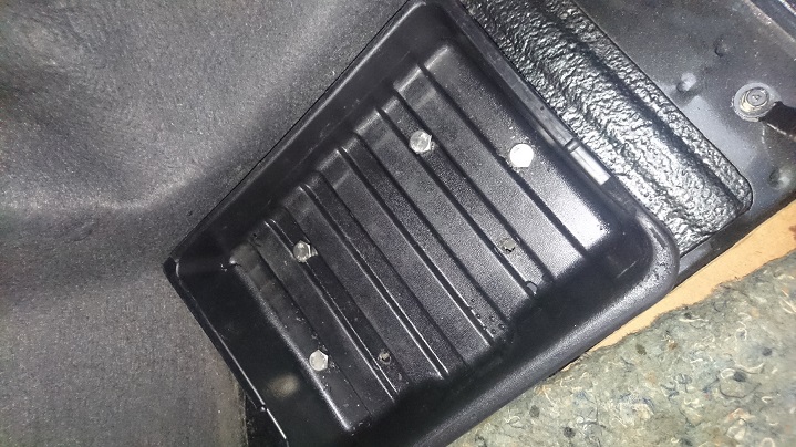

manage to find wira unused tray, recycle lah..actual i re-do the hole.
Put the bolts

Lets dive and screw tight the tray

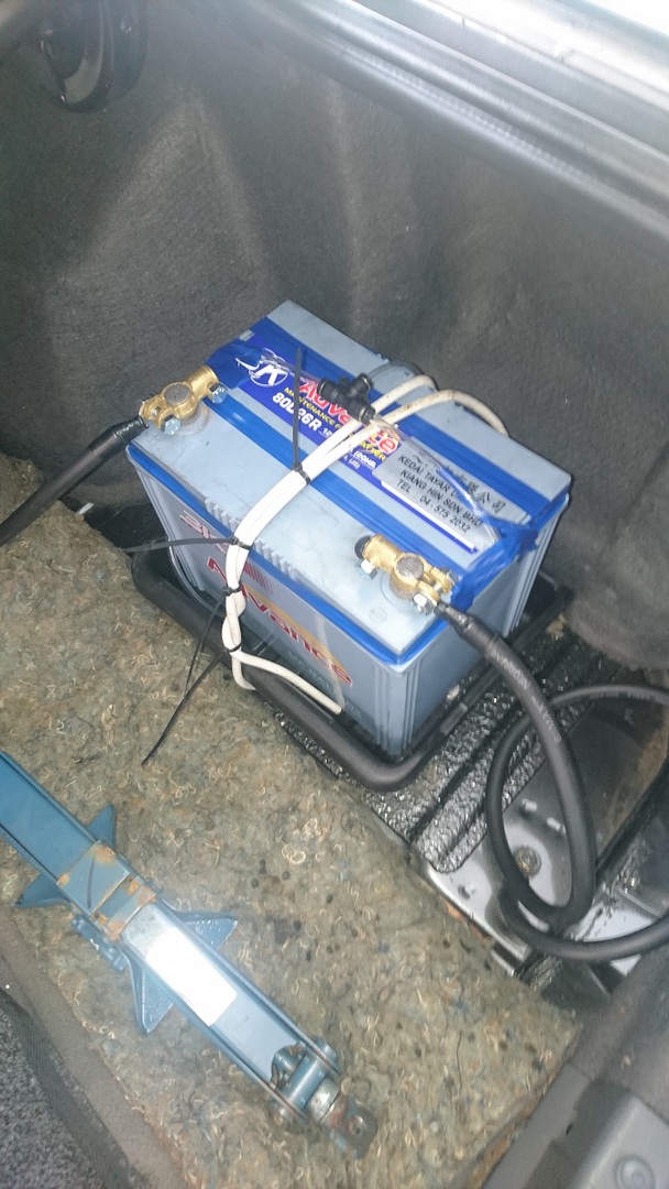

temporary put everything in, to get clear picture for final detailing.
I also get some tube and fitting, foc, hahaha...it seems that battery have 2 vent hole.
Too messy, i think. Will get enclose box at tesco / aeon later. Make venting tube, quite a challenge.
https://www.zerotohundred.com/forums/attachments/561862.vB
Don flame lahhh....i know very dirty. Phase by phase detailing. :vroam:

nice bro..doing the same thing..batt at my rear.. looking forward for some inspiration from you, rear ventilation. For now, every now and then, i just open up my boot
does battery relocation to the rear, really helps with the car weight distribution?
why always on the right and not the centre?
weight distribution ? applied for race car or sports car kut.:driver:
i only see good spot with no interruption for stuffs.
My case, is engine bay fit with new intercooler piping, battery interrupted my bonnet closing.

Ah! Ok! not fully done yet. I saw all cable tie nicely thought that was it.....hahhahaha
