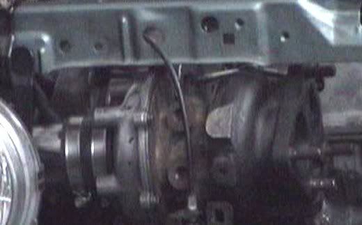

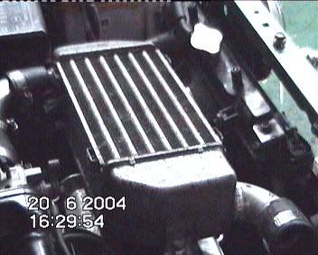

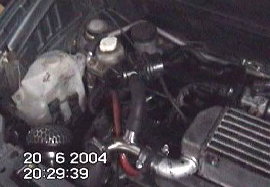

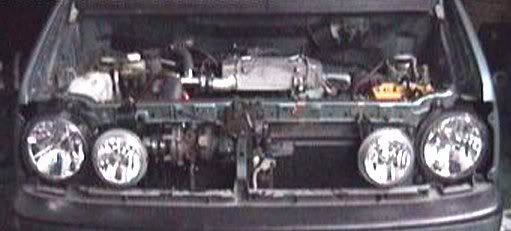

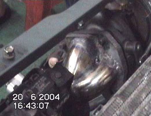

Bolt on turbo kit:
1. intercooler and piping stainless
2. turbo manifold -not stainless
3. air filter piping stainless
3. downpipe (not buang luar)
4. manifold welding
5. mazda b6 turbine hybrid (bigger twin fin) IHI RHB5
6. blow off valve (L2 and Rx7 standard)
7. injectors (starlet turbo or proton 1.5)
8. etc. (oil sump,bla,etc.)

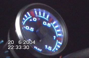

9. boost meter ayam EL light. (bought from racing fit)
with workmanship: rm2000 for kenari, rm2100 for kelisa
turbokit only: rm1650
add another rm500 for my apexi safc I blue screen
this kit has been taken out from my car..reason: my dad wanna sell the car.
PM or sms me at 0193871608.
my location: petaling jaya.
