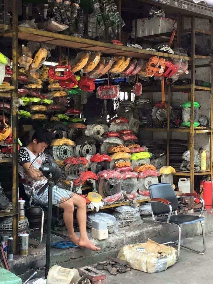

These are still the safest aftermarket bbk to date:

If you put side by side with an original one it's easy to tell when you open up the guts usually the piston area and the oil seal area. The finishing works, stamping and marking you can find them all on the original to be very details and clear, wall finishing and oil seal finishing on genuine brembo are very smooth while replica one are rough and have sharp edges on the oil seal area.
Replicas they usually spend most of the attention to where our naked eyes can see, and the unseen they don't pay much QC or attention to it. It's the same with replica wheels. Copy the rim face like original but turn the wheel back and see, you will find all the worms.
There's a demand for these fake Brembo and this drive the supplies up. Most of these users are just looking to have the look of a BBK and not actually utilising it to it fullest or fit them because the car "needs it" is more of a "I want it, so my car can look good"
