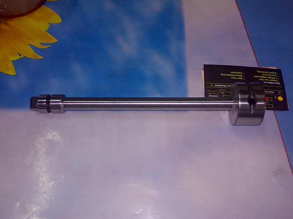

Just want to share our "AMS wannabe balance eliminator kit". And its weight 400g.

nice piece
whts the price like for one of those , vr4
just take out ur ori balance shaft and sent them to machine shop laa cost lest then purchasing new so called race balance shaft. Actually they also machine it from the OEM unit.
