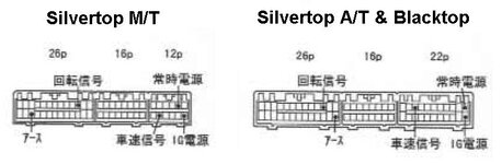

sifoo levin,
just need ur advice and check.attached files are photo shown wiring tapping or terminate rsm through ECU wiring, just need to clarify with u if i follow to tap like this attachment, it should be alright? because u r ECU legend master in our ZTH forum. hehe:proud: need get approval from ur sides...hehe

Wiring Diagram for APEXi RSM (old type) for SVT/BT
Black - Ground (E1)
Red - IG Power (B+)
Orange - Battery (Batt)
Yellow - RPM (IGF)
Green - SP2- IN (not use)
Blue - SP2+ IN (not use)
Purple - SP1 IN (from Speed sensor)
Grey - Preset Speed Triggering Output (max 1A sink current)
White - Preset RPM Triggering Output (max 1A sink current)
Brown - SP2 OUT (not use)
Pink - SP1 OUT (SP1)
Theoretically, with minor modification, we can use "White" to support launch control...
