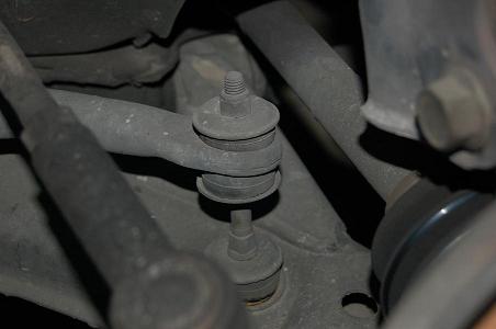

Also, I need to get the little bushings for the swaybar endlinks. Looks to me like there are 3 of those on each side. Does anybody know where I can get these? Are they expensive? I've attached a picture of it so you know what I'm talking about. Thank you very much for any help with this.

those small bushings are on almost every toyota & other cars as well..
spare part shops call them satay bush... cos its like being pierced through.
You can even use skateboard truck bushings for them... they're even
higher quality than your stock one cos they're made from polyurethene
with different hardness to chose from. For car brand u can try superpro
bushes or TRD
Thank you very much, sexycar! Skateboard truck bushings would work too? That's great cos I have a skateboard which I never use, maybe I can grab the bushings off those Fury trucks! Are the Superpro bushes made of polyurethane?
