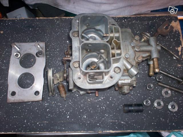

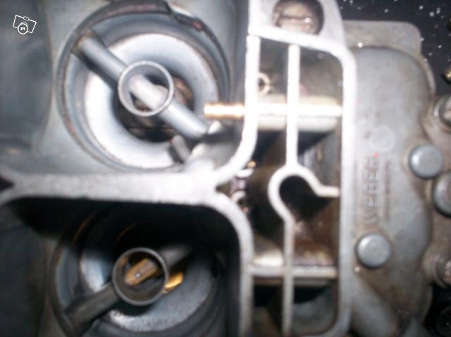

one of my fren at taman titiwangsa have 1 set this caberator..
but not sure still have or not..
if u interested i can give u fon number for call
carburator weber DGAV 32/36+tapak for 4g91
Price: RM 350
this is pic show u everything!!!
:biggrin::biggrin::biggrin::biggrin:

come! come! buy this carb, so i hv geng hahahahahah
hahaaahaha..suka ar..
but i'm not sure still have or not..
becoz he also posting at mudah.com 3day ago..
try ur lucky la...

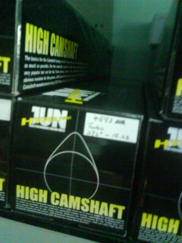

Jun's website last updated 2nd October 2008 leh... don't see them mentioning anything about coming out with 4G93 high cams... unless it was launched at most 8 days ago lah! LoL... =p
Bro Jun cam for 4G93 Available lar ....
its Custom order from Jun from our malaysia performance distributor ..... u can check at GT Auto KSP and S S Racing :) u can give a call to JUN Japan Directly and I did call them previously..yes..they do manafacturer Jun 4G93 Cam .... by request only
I dont think GT Auto, KSP & S S Racing will cheat ppl
Cheers
Refer photos
http://i67.photobucket.com/albums/h317/sky222/DSC01824.jpg
http://i67.photobucket.com/albums/h317/sky222/DSC01825.jpg
http://i67.photobucket.com/albums/h317/sky222/DSC01826.jpg
http://i67.photobucket.com/albums/h317/sky222/DSC01827.jpg
Go to the website and check for urself lor... of course i'm SURE lor... =p
Dun take this the wrong way, but you really expect me to believe you called Japan meh? I wouldn't believe anyone who says they call Japan lar, unless they speak Japanese. Unless you do. =p
Pictures mean nothing dude... Those that come from China also 99% close to original packaging wan. =p
Wonder whut other wayz can we know its the real deal?
really ler...... its original from Japan 1 ler...u can search their phone number or email them...they can manafacturer for u ....what u mean is GT Auto . SS Racing and KSP Sell fake stuff loh ....ermmmmm
forgot to tell u ...my brother is working with mutiara motors in Jb and able to speak japanese... and we clarified with JUN , well ... website last time i also check b4..and really dun have ..... I also doubt ..but now i got a clear answer ...
