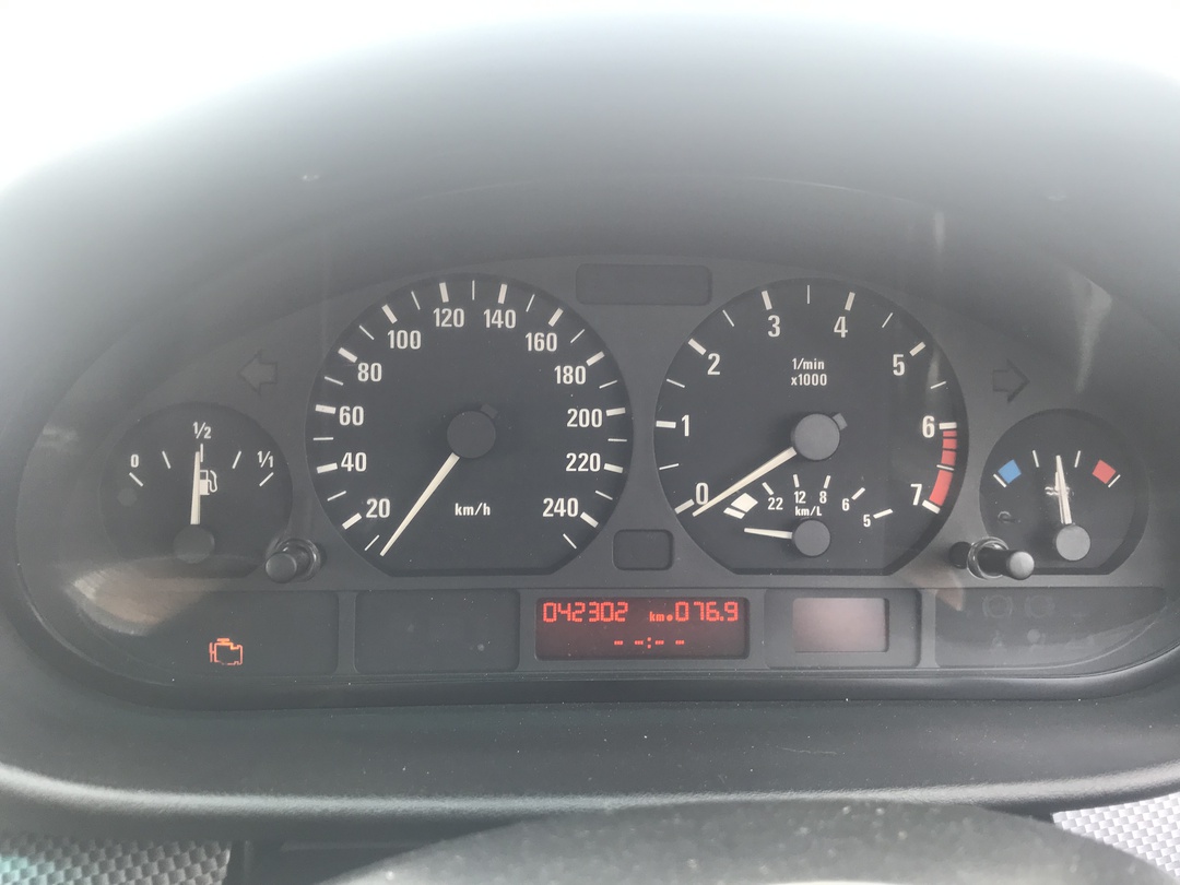

Hi All,
It's me again, so i have a slight issue with the 1JZ E46, seems the RPM will drop dead itself when i stopped at traffic for too long. The engine is very alive and the speed, fuel indicator, and water temperature is operating. Only the RPM will drop dead by itself and CEL will turn on. See picture for clearer picture, in the picture, my car is still alive with A/C on and radio is on as well. Car still drives fine and nothing strange seems to happen. The issue can be solved by simply restart the car again.
BTW I am using Dakota Signal Interface to mate the cluster with 1JZ. No lose wire or anything is found. What could it be the issue ?
