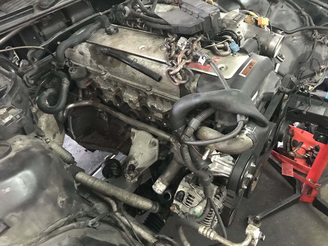

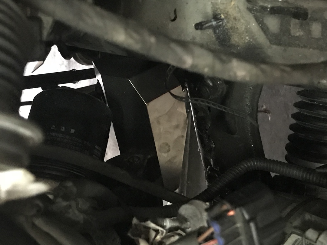

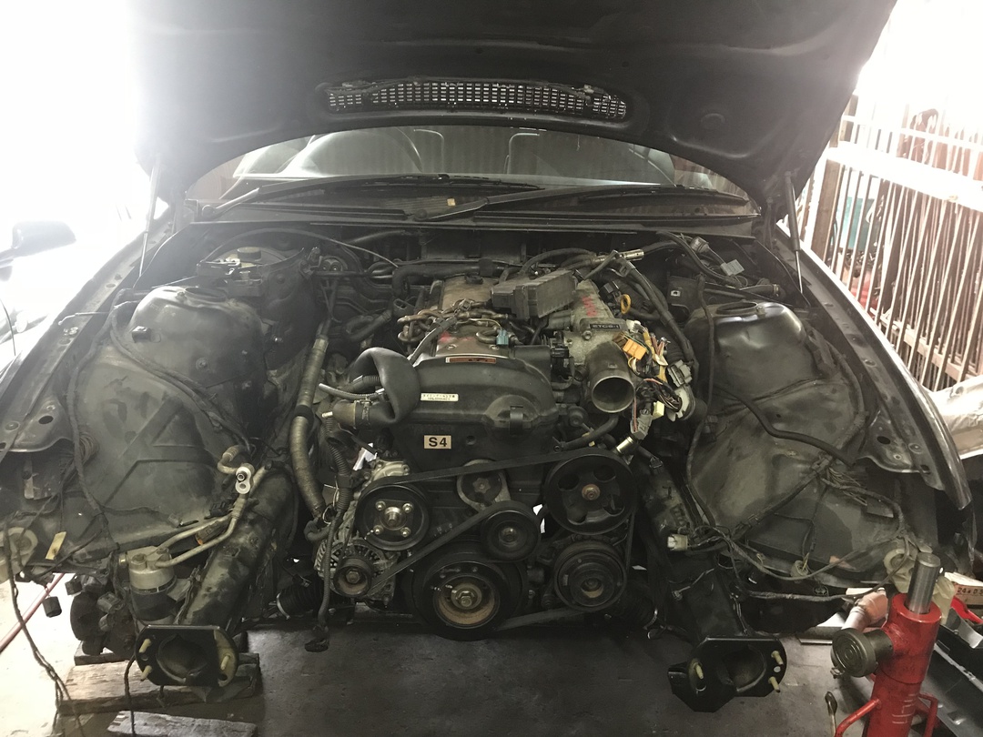

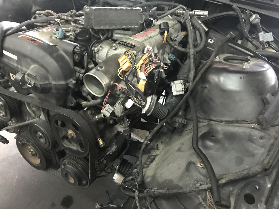

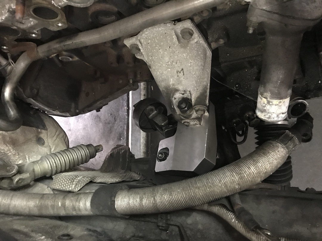

Hi Alcyon,
My E46 before engine swapped was having 110 km/h at 3.1K RPM (No kidding). GPS speed is 105 km/h, the original engine is M43B19 with ZF 4 Speeder. If my mechanic and me was not wrong, my rear diff is 4.04, hence, the initial take off for such a small engine on a heavy body is very nice but it would not impress me anymore after 13 years of owning it. I have uploaded the pictures of the engine installed in the bay and the billet mounts that were customed, apparently it was a little thick that i could not close the hood completely as the engine is very near to the hood, skimming 5 mm solved the issue, only thing is, i may not able to fit a struct tower bar. See below:

Hi Alcyon,
View attachment 572137 View attachment 572138 View attachment 572139 View attachment 572140 View attachment 572141
