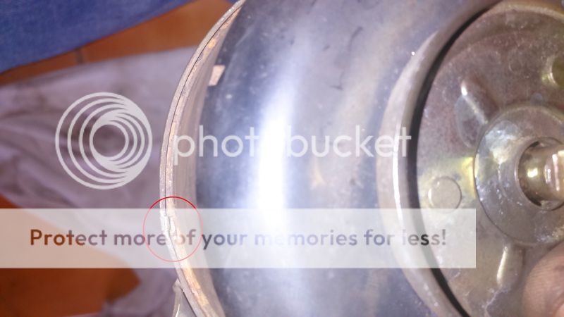

1. The Motor:
2. Twist this part little bit.
3. After twist here and there and slowly tap it with hammer, there we go:

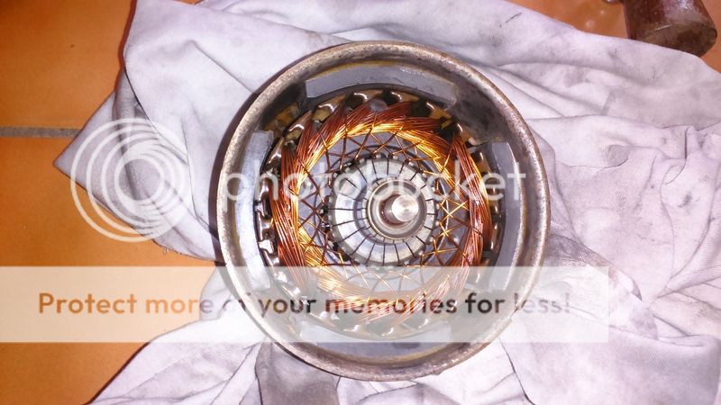

4. Looking at the carbon brush still thick and the commutator still in good condition, next step - pull out the armature from the housing (It is felt 'heavy' to pull because of the magnet inside the housing):
5. After components dismantle and please take more precaution to the washer and the carbon brush spring:

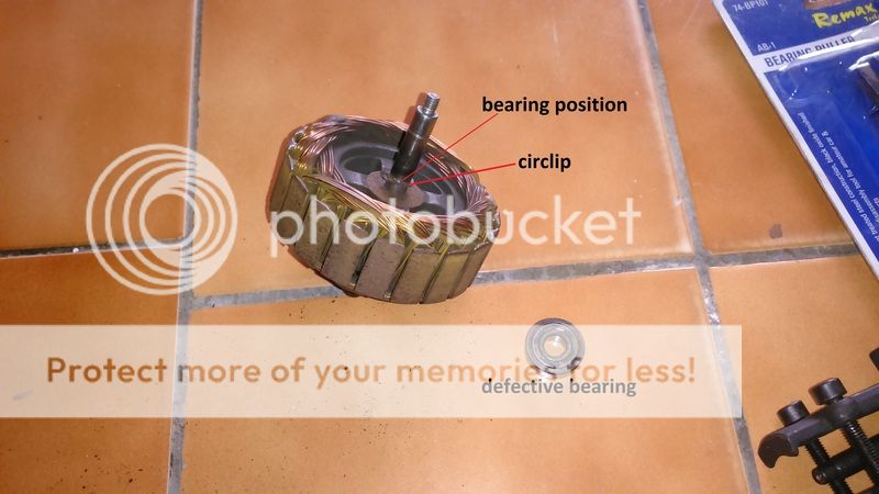

6. The bearing seem not turning smooth and felt heavy to turn. I suspect this is the reason of the symptom of abnormal sound and fan heavy to turn.

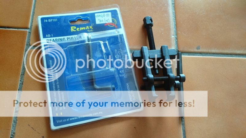

7. Using the bearing puller, pull the bearing out from the shaft:
8. Clean the component (I just use liquid dish wash and brush it with toothbrush). After that, put it under the sun to make it really dry.

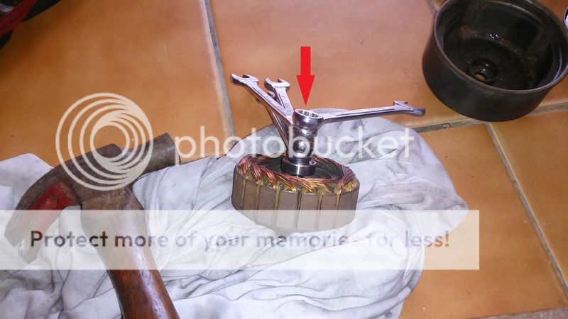

Went to buy the bearing and insert it to shaft. Since there is no proper tools, I just use a spanner (8 mm) and slowly tap it with hammer) and add more spanner
until the bearing at original position. (Note: to make it more easier, lube the shaft with WD40).

If the result at paragraph 13 as stated, no sound of abnormal and it turn smoothly then this means the repair successfully. For this project, i spending RM50.88 for the bearing puller (I've been told it will cheaper if you send it to engineering shop) and RM9.50 for the bearing. The total are RM60.38. It is lot cheaper compare to buy a second hand corroded motor and need to modify for RM212.00.
