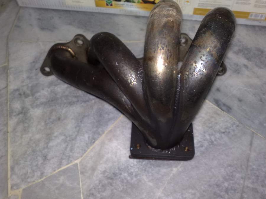

aleo i got turbo kit taken out from celica 3sfe....comes with manifold,turbo n downpipe.....hahaha
how much bro?if i install it need to change piston not?n ecu setting????...
