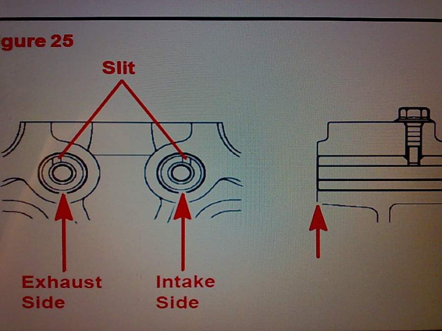

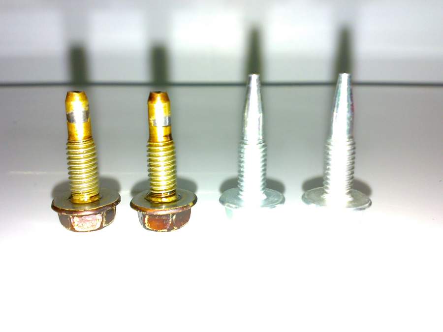

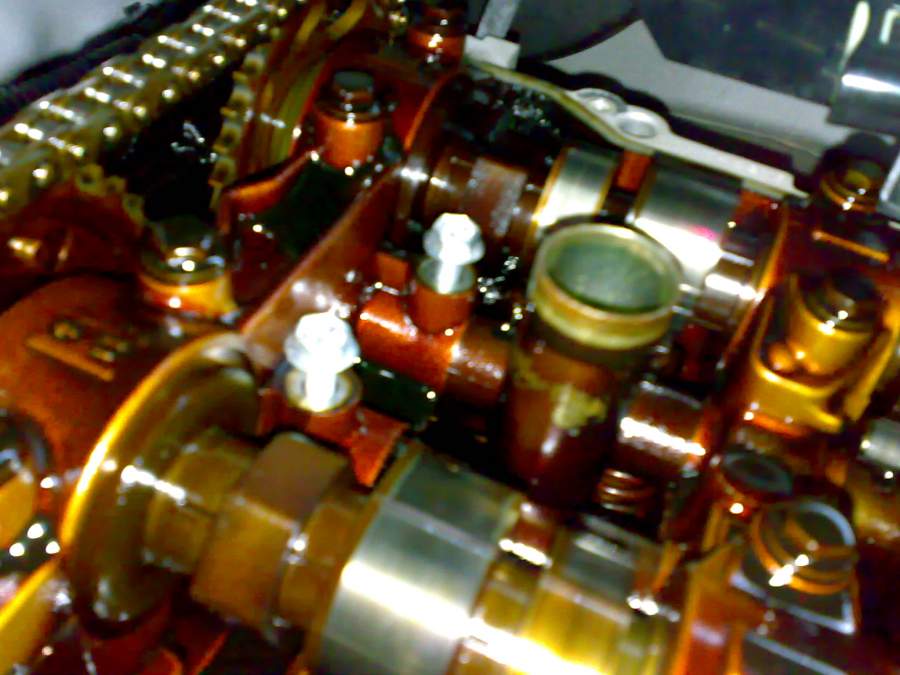

lift bolt securing the rocker shaft separates, allowing the shaft to rotate in its bore,this rotation,when it occurs, can cause misalignment of the oil feel passages to the rocker shaft, resulting in a lack of variable lift operation and low power at higher engine RPM.
no lift when lift bolt is broken!
Bump:
see the pic

update...better do lift bolt change with reputable workshop...otherwise if wanna diy then rm10 per pair...
