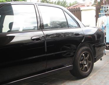

Hi all,
I am just wondering which of the 2 coil spring will make the rear height higher ? I am currently having a GAB absorber + Waja Coil Spring + thicker bush, but my car doesn't seems to look higher, is only 2 finger.
Will 1.6 APM spring help if i replace with Waja ??
My car is a Wira 4g91.
Thank you

u sure u rear spring is taken out from waja???
waja ori rear spring is around 5 fringer geh lo.

Thanx Waja2003 for the comment. But how do I check the spring is WAJA or not ? The tyre shop did compare my stock spring with the waja spring he shown me, it is longer than my one. But I am doubt on the stiffness of the spring. I did not compare the diameter or roughness of the spring though, only the height i saw.
Attached is my car height, you can see is not high at all, it is just normal, i have tried again is 3 finger, not 2. My expectation is with this setup (GAB Sport abs+thick bush+waja spring), it should be higher than the normal, but it is not
Thanx.

whoa wut tyre u size n rims u use bro?? as for me im using waja spring for front and rear.. with 205/50/16 tyres im using now.. i can get 4finger gap between the tyre and mudguard... without using any bush and only apm 1.6 wira gas absorber.. how come ur spring is not high r?? maybe not waja i think..

i think u 1 is wira 1.6 spring only..
if waja spring with out bush also very very high ady 1..
