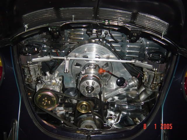

RS4wd
Dec 16, 2003
314
3,018
bro,
wondering the 2nd pic u posted....looks powerful dude!!
was that engine sourced from porsche?heeh
