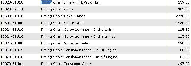

wah like that means i need to change my timing chain oredi lor .. any indication of cost? found these items under timing belt.
