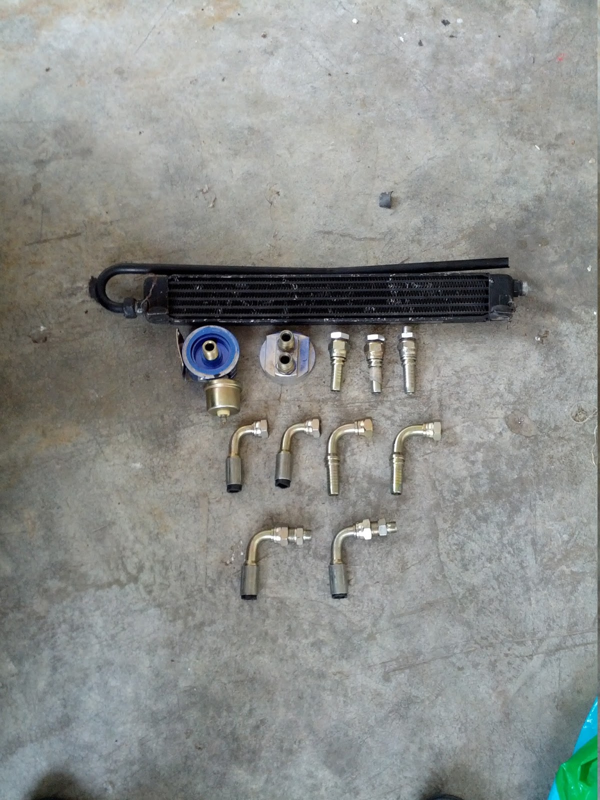

If use garden hose clamps cannot meh? or maybe able to find a specific clamp at hardware shop,
buying a complete set is a waste of $$$.
u pasang the cooler edi ah?
vr2turbo
((( God Level 30,000 RPM )))
Helmet Clan
Moderator
May 11, 2010
30,001
8,385
1,713
Petaling Jaya
No la, need to clamp the fittings ma. Sort of like metal fittings.
Those anodized ones.
I think you mean "crimp fittings" where you joint the hose and the ends together.
https://www.google.com.my/search?q=...m%2Fproduct_detail.aspx%3Fid%3D251634;440;285
Yup, some air con shops does it....
u pasang edi the cooler edi ah?
At first I also think can just go spare part shops get the hose clamps....hahahhaha:biggrin:

Stupidcar,
I oso made power steering line, ATF cooler line from that workshop too...

Hihihi,
Anyone knows where to make oil cooler lines?
Or at least where to clamp those fittings?
Thanks.
Hi bro.
are you in klang valley? in shah alam there is one shop call Inland industrial Instrument. They are do lot of hosing work. Work next door to them last time. might it help.
Inland Industrial Instruments (M) Sdn. Bhd.
Address: No. 23, Jalan Juruanalisis U1/35, Seksyen U1, Hicom Glenmarie Industrial Park, Shah Alam, Selangor, 40000
Phone number: +60 (0)3 5569-5199

Hi bro.
Hey thanks.

Hihihi,
Thanks.
if clamp/hose type just use hose clamp and oil-rated hose
if the threaded type bring oil-cooler and screw banjo fitting to tracktor/jcb sparepart/machine shop and they will do custom hose for you....
