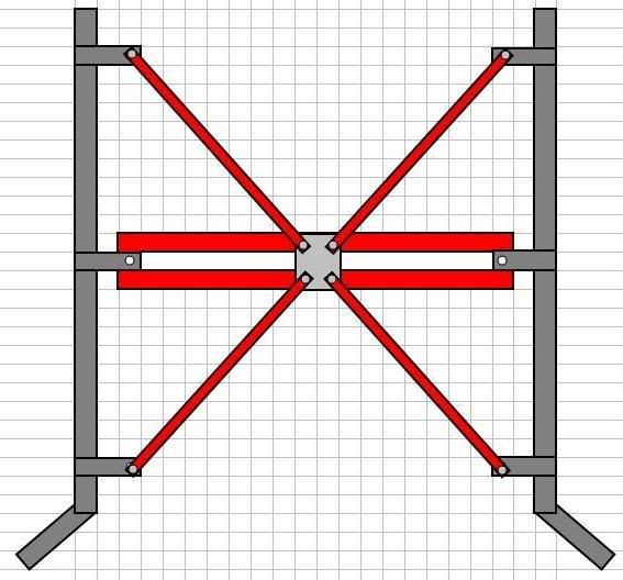

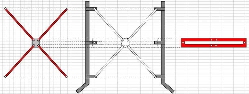

Subframe Connectors - basic design by defcon1 for the 1996-1999 Nissan Cefiro.
Components of the Subframe Connector :
The completed structure :
The diagrams are, of course, not to scale. But I should be doing some basic measurements this weekend so that I can complete the schematic and get someone to begin fabrication... :smile:
