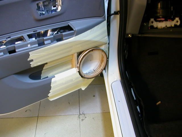

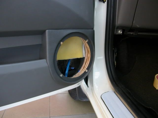

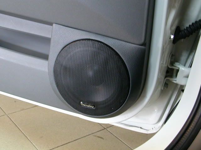

Front speaker is 4", rear is 6.5". If you're looking to just change and be done with it, suggest you don't waste your money. If you're looking for improvement, spend about RM1100 for a good high sensitivity component set for the front + door panel mod and that'll make a helluva lot of difference. Forget the rears.
CV Audio Damansara has the setup I mentioned in their company Myvi and you'll be asking youself where they hid the amplifier. Contact CV Audio Damansara here : C.V Audio Sales Outlet
They've got a great deal on a 5-channel Alpine PDX amp too.

If u intent to make hole in u r door panel, please go to a decent shop, dont go for cap ayam shop and u will hear all kinda sound from u r door panel. Sifu here can help u with decent shops.
Oct 15, 2009
3
1,501
Suggest to find a good shop to modify ur myvi front door panel, dun use the market selling casing, it is impossible to make ur mid bass have a good sound.
