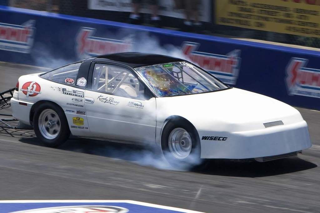

A very nice write-up and one of the legendary 4g63 cars to run FWD and achieving 8 seconds 1/4 mile , the setup isnt simple at all , mind you , look at the intake cam , its a MIVEC evo9 system

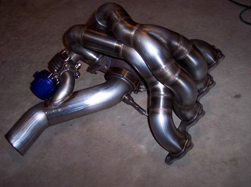

i gotta re-calibrate my brain. for turbo, having a loooong winding header is okay.
i bet it's laggy as hell below 4Krpm (yes i know it's fer drag oni)
nan83
Nov 14, 2004
238
35
3,028
Pasir Mas,Kel
of coz lah... longger manifold give lower backpressure... we oso can separate exhaust gas form each cylinder .. exp. cylinder 1 on overlap (intake) ... cylinder 3 on exhaust stroke... so exhaust gas from #3 cannot go direct to exhaust port cylinder 1 that can cause exhaust reversion .... it same concept with twin scroll .. long runner + twin scroll = low back pressure & good scavenging effect.. from that we can run more aggressive cam, lower cylinder temperature, more aggressive tuning ( less fuel & more ign timing coz of cooler cylinder temp) , engine VE increase much at hi rpm... anymore advantages?? share2 lah...

Longer runners allow less curvation radius... Less exhaust flow restriction
