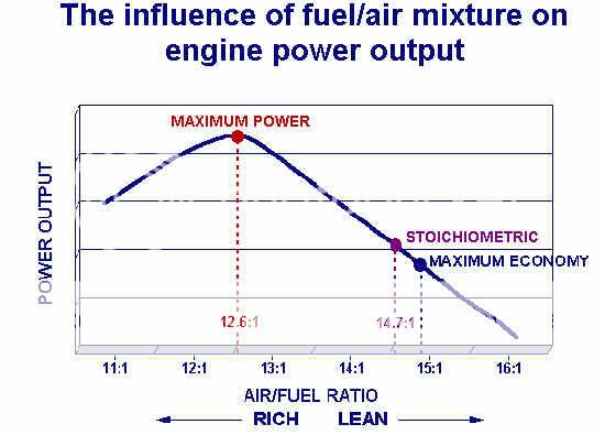

Oh, so theoretically max power is made at AFR 12.6? I'm confused, some tuning articles that I've read mention that more power can be made since factory tuning is rich..
that depend on which factory tuning...i suspect saying that was applicable for american cars with carbies... :adore:
well like example of newer generation proton (campro+siemens ecu) mostlikely the tuning was on the very edge of lean...i've read somebody wrote that he dynoed a stock campro car with 16:1 afr....
most boosted ride would opt for richer 13:1 afr at WOT in order to gain highest power and keeping the engine part such as piston and turbine cool enough..(too lean could result catastrophic piston/valve/turbo failure)
if daily tuned ride i would say 14:7 afr was among the best and safer choice...which balance the fc and temperature....

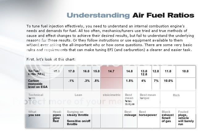

Hye, i just wanna share some experiment & little info to all zth forumer..I've been using Wideband for a while, its brand Innovate and have tested to my car and other's is my friends car which is Honda FD (Mine) / Swift (Mine)/ Inspira / Saga FLX / Satria 4g91 Carbie in standard stock Factory, the result is..
Honda FD - Partial Open Throttle 14.7, Wide Open Throttle 11.5
Swift - POT 14.7 , WOT 11.5
Inspira - POT 14.7 , WOT 11.5
Saga FLX - POT 14.7, WOT 12.3
Satria 4g91 Carbie - POT 12.5, WOT 11
The conclusion is Factory Setting would be around 11~11.5 AFR and its rich condition, with ecu management such piggyback / reflash / Stand alone will trim WOT until 12.5~12.8 for N.A and 11~11.5 for TC or SC. I was very impressed because wideband reading for saga 1.3 FLX already nice and suit for best torque. For carberator fuel system it seems a little wasteful at cruising /low rpm since the reading much higher than other new injection car. Thats the benefit of injection system since its control by ECU management. Just for sharing :rolleyes:
Here are some schedule thats i always refer for self tuning...
