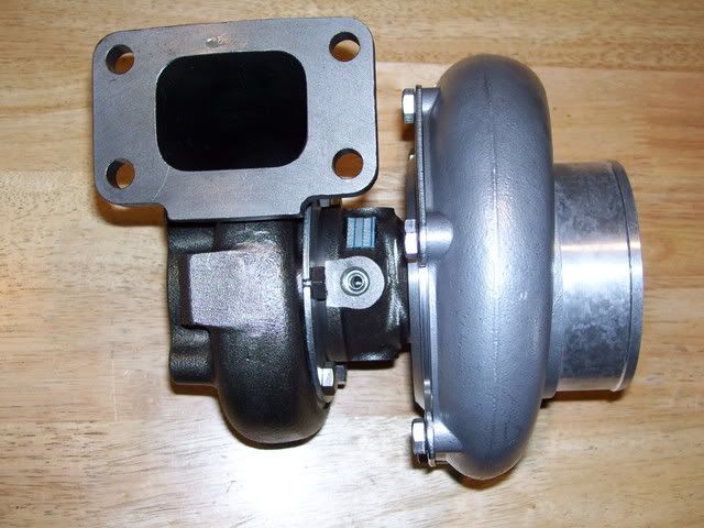

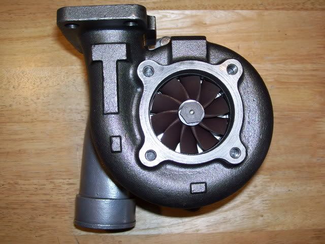

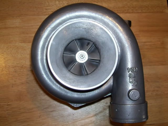

Compressor- 62mm inducer, 82mm exducer; 6-blade.
Turbine- 68mm inducer, 62mm exducer; 10-blade.
T3 turbine inlet, Garrett 4-bolt outlet.
4" compressor cover inlet, 2.5" compressor outlet.

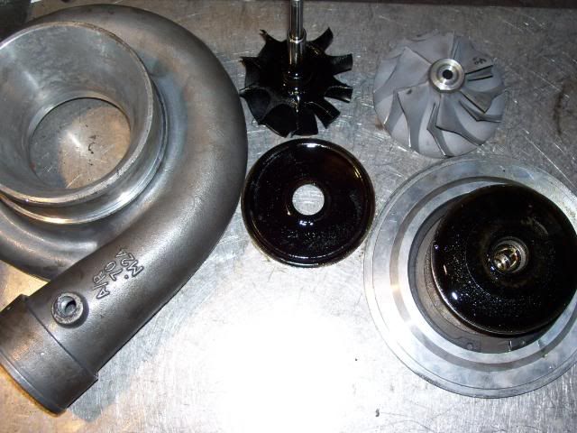

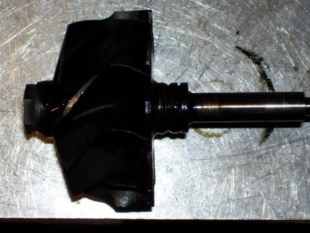

It lasted 400 miles.....barely enough time to get the car tuned properly. We installed it by the books- ran the oil feed to the head with an inline filter and a volume restrictor, and it STILL died. I'm rather disappointed- it really appeared to be quite a well-built piece. I'm going to pursue a warranty claim from the seller, although I'm probably just going to get a poke in the eye. If they don't want the turbo back or are unresponsive to my warranty claim, I'll rip the turbo apart and try to see what exactly what went wrong
So, I suppose now it's time to spill the beans.....
This turbo was a JOURNAL BEARING turbo ALL ALONG. The seller BLATANTLY LIED in the listing....so you could see why I was a little upset. For not much more than I paid, I could've bought a new journal-bearing Garrett. I bought the turbo BECAUSE I thought it was a BALL BEARING UNIT as the listing clearly stated.
Here's the photos that I didn't want to post until I received my refund:

just finished reading sum of the posts in the thread u posted, the turbine was fecked because of the restricter kan? it wasnt because it was a china turbo? nice

good post unker jin.even on the medium quality picture upon closer inspection i can see abit of wear marks..400miles is a joke,even if its a china-made turbo they still want to make a turbine that can be used after selling right,being a business man i dont think they meant the turbine to break.
however,even with their so called quality control,this happens.I'm glad you came out and share this with us.
