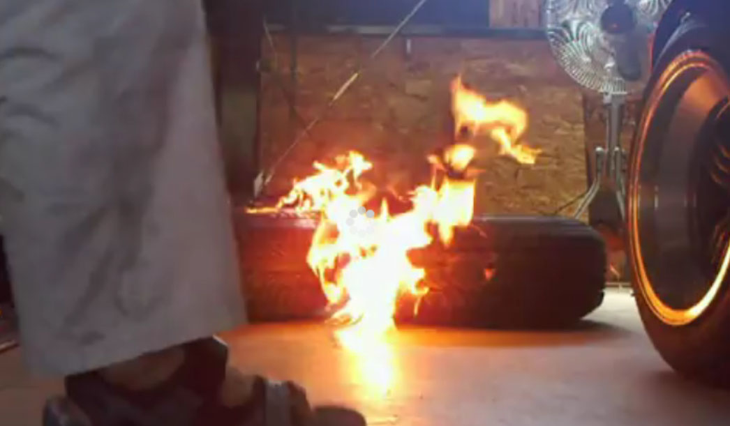

Fitting a tyre on a wheel is easy. To stretch a narrower than suitable tyre to a wider wheel require a different set of skills as the regular practice will prove almost impossible. This exploding propane technique is one of the many homemade ways to stretch a tyre onto a wider wheel. Though we'd not recommend anyone trying without proper safety measures.

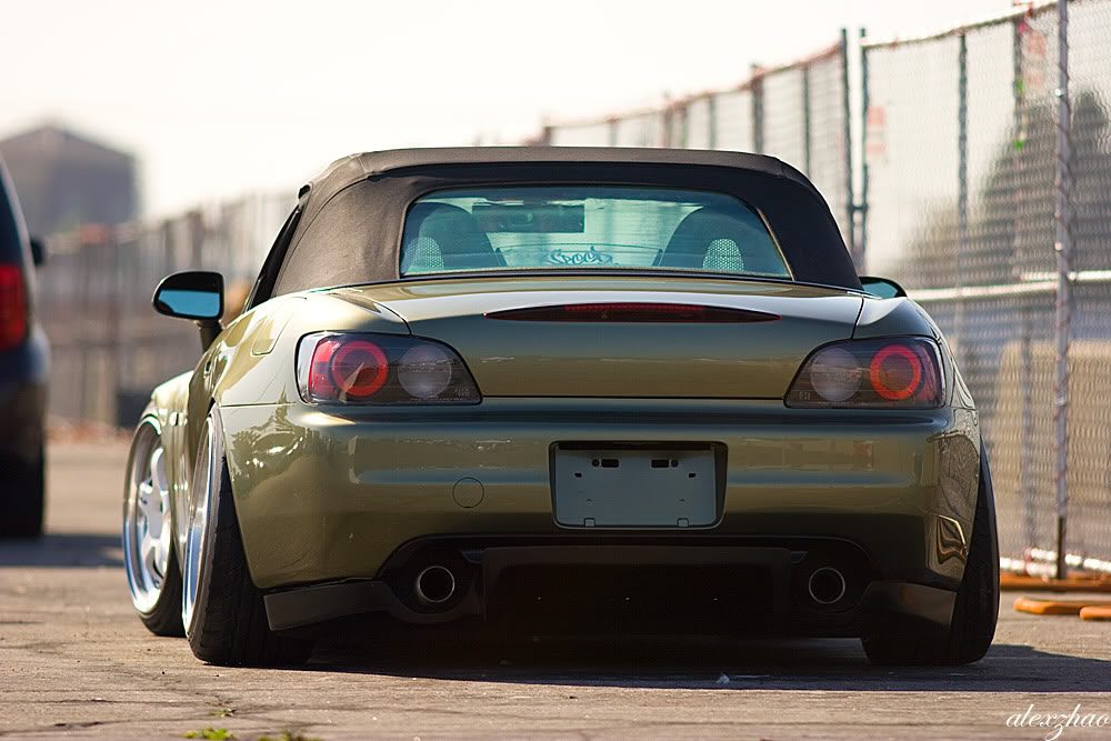

what is stretch?
"stretch" refers to stretching a narrower tire over a wider wheel, the sidewalls stretch from the lip to the tread

any reputable wheel/tire shop should be able to do it. i know when i did a 215-45 kumho on a 8.5" wheel, it took one shop 90lbs to pop the bead. getting a 225-45 on a 9 and a 245-40 on a 10.5 took another shop 50 lbs

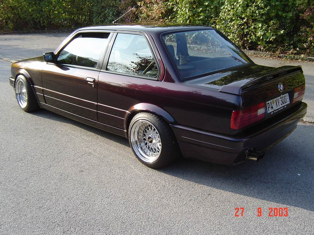

from what i have seen, the best tires with regards to stretch are:
toyo t1-s
dunlop sp9000
dunlop sp8080e
falken fk451
im sure there are more, but look for a tire with a rounded shoulder and a lip protector, they tend to give the "desirable" look

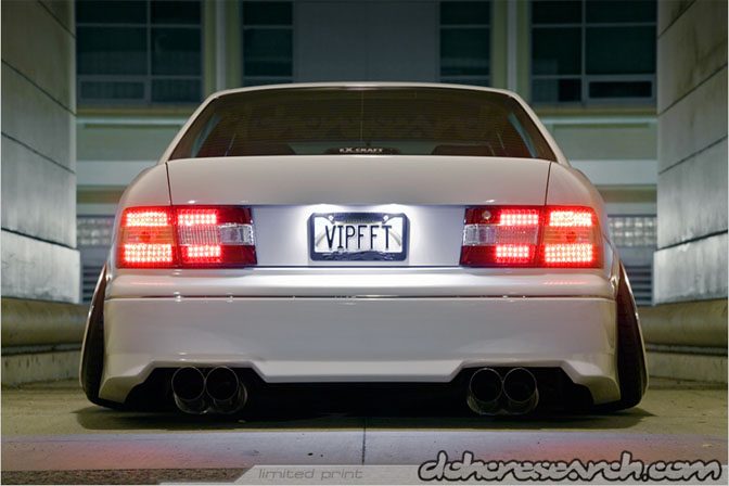

what size/offset wheels are the best for a staggered look
its all about personal preference. me, i have 17x9et26 and 17x10.5et26 and i couldnt ask for a better setup. some may not like the look but thats why people build their cars for themselves

They used propane or butane liquid gas to spray around the rims and then they made a "guide" line for safety precaution by spraying the gas out from the rims, just like a dynamite with that burning thread. Then they ignite the gas, its highly flammable so in that short period of time, a vacuum will be created around the burned gas. The tyres will be sucked outwards due to the strong suction from the vacuum area.. just like the black hole, suck everything in :D

off-roader use this style to install their off-road tyre....much faster than waiting air going through the valve.... :adore:
but if not mistaken tyre shop in malaysia use something similiar to "compressed-air BOMB" where it got tank to store high pressure compressed air and a quick release valve.... correct me if wrong... .:adore:

where to get the propane? i know where to get the butane (it's the cooking gas right?)

i guess mosquito aerosl spray can be used since it was flamable oso???? :adore:

any aerosol spray can that is combustible... concept of air expand when heated...
