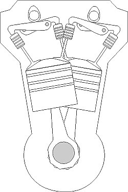

In 1991, a breakthrough was achieved by Volkswagen. It developed a narrow-angle (15°) V6 displacing as much as 2.8 litres and installed it to the generation 3 Golf. As everybody knows, this is the so-called "VR6". As seen in the picture, the VR6 is really very compact, nearly as narrow as any inline engine and not much longer than a straight-4. It could be fitted to many small cars, including Polo (which didn’t because of price reason). It is also supplied to Mercedes-Benz V-class, whose short front end cannot fit Mercedes’ own V6.
VR6 could be as narrow as 15° without cylinders overlapping is because adjacent cylinders are widely spaced from each other, as seen in the following pictures. This inevitably increase its length but the result is still just equals to 4 and a half cylinder, versus a V6’s 3 and a half. For most small cars this is short enough.

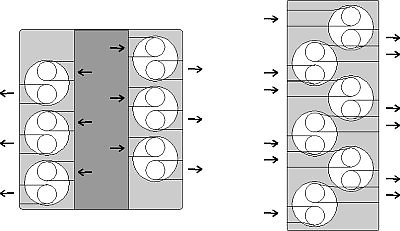

Another feature of VR6 is very important for our further study of 24-valve VR6 and W-engines. It is: the VR6 is asymmetric. For conventional V6, one bank of cylinders mirrors another bank, that means, air intake from the center of the V and exhaust pumps out from outside of the V. (Not vice versa, because the inside of V cannot accommodate the very hot exhaust pipes.) Now please see the illustration in below ....
Left : Symmetric design of V6 Right : Asymmetric design of VR6

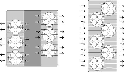

... the VR6 has the air intake from one side and exhaust from another side for ALL cylinders, no matter in which bank, so it is not a symmetric design. Normally, induction manifolds take place at the top of the engine thus waste no space, it is the hot exhaust pipes that engage a lot of space (or length) of the car, especially is a certain clearance should be provided to avoid overheating to surrounding components. Now VR6 concentrate all the exhaust pipes to one side of the engine, thus save space.
The same cannot be implemented to conventional V6s because their adjacent cylinders are packed so close to each other thus provide no space for induction / exhaust pipes running to the same side.

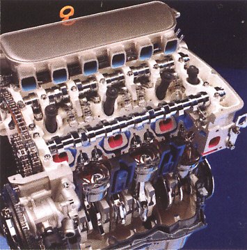

</td> <td> Piech’s ingenious engineers solved the problems by introducing a revolutionary concept: Twin-camshaft per bank, one for intake, one for exhaust, but totalled also 2 camshafts. Yes, believe your eyes. Sometimes 2 x 2 = 2.

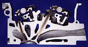

Don't believe ? look at the photo beside. Use a single naked eye to look at the farther camshaft. You'll see the rocker arms pressing valve springs, the direction of springs project to the valves of a cylinder belonging to another bank. If you are not sure, see my illustration in below.
</td> </tr> </tbody></table>
Now it is clear. Camshaft A controls the intake valves of bank A as well as bank B. Similarly, camshaft B controls the exhaust valves in bank B and bank A. In other words, every cylinder is served by both camshafts, hence a twin-cam engine.
If you still remember, a feature of VR6 is that it is asymmetric, this enable the exhaust valves in both bank remains in a distance accessible by a common camshaft. In fact, the distance is the same as in intake valves / cam set. This ensure equal efficiency of intake and exhaust. Without the narrow angle and the asymmetric configuration, the share of camshaft would have been impossible.
Such design allows cam-phasing variable valve timing to be installed. In the 24-valves VR6, the intake camshaft has VVT. In the future, the exhaust camshaft may also introduce VVT, just like BMW’s Double Vanos.
If it were a conventional V6, it would have needed 4 camshafts, 4 cam-phasing mechanism to implement this. Also required is 2 cylinder blocks and 2 cylinder heads. VR6 needs just half of them.
It is also interesting to see the new VR6 has the same no. of camshaft as its 2-valve predecessor. It is one of the most remarkable invention.
