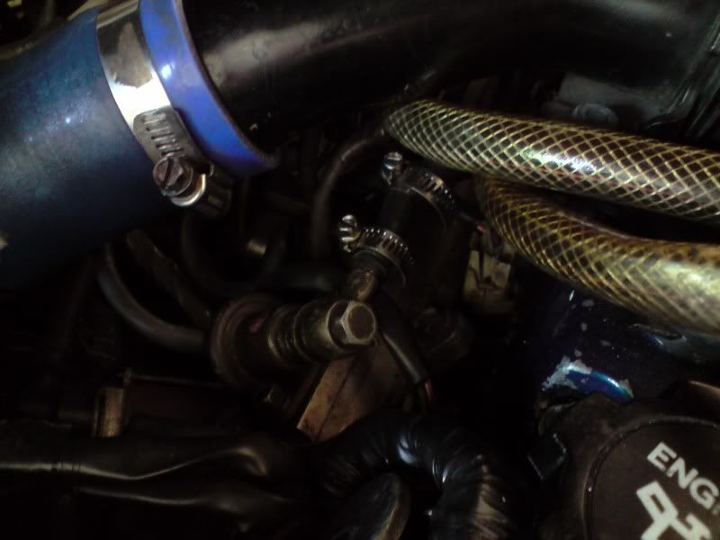

I recently just DIY do a self made fuel regulator, and I do use the about RM 20 to doing it.
Preparation item:
1. Hose Clip x 2 unit
2. Screw driver
3. Samco Hose - 1 meter (depend)
Replace return fuel piping then put in 2 hose clip at return fuel pipe. 1 hose clip for holding up the OEM Fuel regulator and fuel hose piping, and another 1 hose clip for tighten the hose.
After mod, the fuel return abit slower than usual. The fuel pressure become increased.
Problem now is, I can't read currently the fuel pressure.

My way was slightly different... wait i post up the picture, my bro not free to snap it yet.

u clam the hose which the fuel actually return ??? come come show us pic....

Picture Uploaded....

erm...honestly i dun prefer this way coz the hose u clamp now is the fuel return...u r now forcing the fuel to return slow by clamp it....in long term if the hose crack then we will get petrol all over..
by clamp the host the fuel is trap in the fuel rail and the return hose(the part b4 the clamp is placed) in long term the hose will not stand the pressure or heat from engine will crack the hose...prefer on modding the vacuum hose of the fuel regulator to get less vacuum and make the valve open lesser to give more fuel pressure...

agree with caleb_5375, i notice when open throttle the fuel pressure will increase.

it is the moment when we full throttle d and release...the pressure all is on the hose there...no offence but we surely dun wan anything bad happen ....nice DIY oso ...
