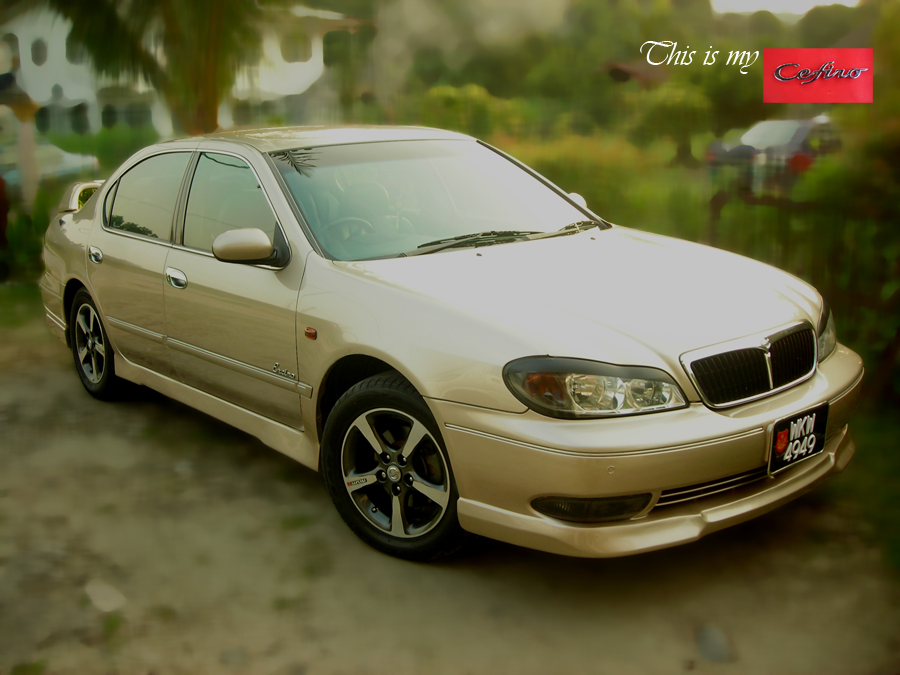

And this my Ceffy new look.

happy to hear ur problem solve bro, btw nice body there :biggrin:
