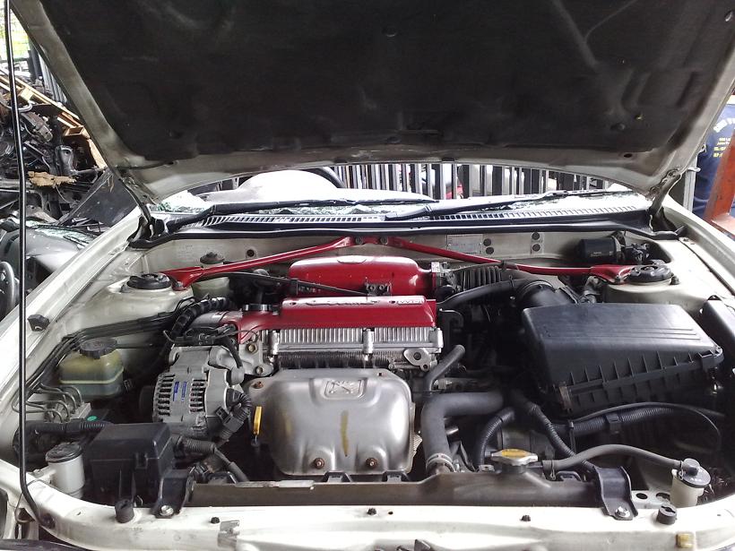

kajang powerspeed 0192174320 Ah Nga.......3SGE dual VVTI is altezza engine can't fit into seg.....the celica st202 beams single vvti i'm selling for RM4K+ without bodyparts.....don't need to potong & welding on the mounting to fit it in......
1 of the old sifoo Qiw ex-car running on this engine
