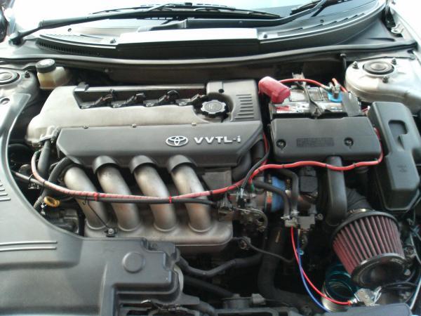

mine is auto, so i heard its no good to use open pot. if i wanna CAI, how to locate the hose? any idea?

stock airbox is already have cool air intake design bro! if u want to DIY CAI u need to bore ur airbox, under the airbox have 1 small hole, u can install intake ram kit at there!

a proper cai will give you 1-2 degree higher air temp than outside air.... at the same time improve air flow tremendously.....
sri without heat shield will give you more air flow but air temp will be about 15degree above outside air....
*tested and monitored with pfc.
